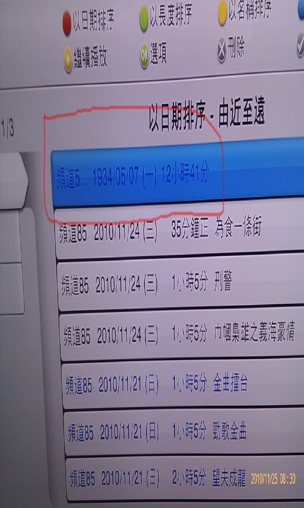

作者:Li On (115.xxx.xxx.66) 發表主題:111 回應文章:1556 日期:2010-11-25 15:40
leeon hing, that seems very weird! If the USB drive is formatted by MagicTV, please do a "Check and Repair" on the USB drive. If that can not fix the problem, please bring the USB HDD to our office to check.
regards,
Li On

作者:leeon (183.xxx.xxx.115) 發表主題:85 回應文章:281 日期:2010-11-25 08:43
利安,部5000d突然之間多左呢個怪files,一入去就hang機。我試過駁落pc度睇,找不到這怪雞files!help我不想fromat usb harddisk,入面有好多嘢
