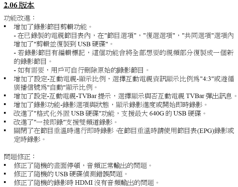

The Editmark function is in firmware 2.05 a month ago. If user used Editmark, then using 2.06, a simply "cut" all programs will do the job. Though a little time and space is needed...

Eddie Wan hing, 10mins difference maybe too little to reflect on the total remaining time.
You can do a test, for example, take a longer (1.5 or 2hours) HD recorded program, delete it (move to trash). The recording time should increase.
Un-delete the program, and mark MOST of the recording as unwanted and make a cut program of just a few minutes.
Then delete (move to trash) the original long recording. The recording time should increase.
After the test you can undelete the original recording, remove the editmark, delete the short "cut" clip and return everything to normal!

作者:Li On (203.xxx.xxx.61) 發表主題:111 回應文章:1556 日期:2008-10-11 21:25
Eddie Wan hing, of course the quality is the same, because the data is the same!
But people will always have their own opinion and may not want to believe digital is digital...
regards,
Li On

作者:Li On (203.xxx.xxx.61) 發表主題:111 回應文章:1556 日期:2008-10-11 19:49
Some tips on Editmark operation:
- cut from the beginning:
play from the beginning, press X once the timebar show up at 00:00, later mark a V (tick) when the wanted video start
first mark a V (tick) when the wanted video start, then press the green left < key (5mins jump back) to jump back to the beginning at 00:00 and mark a X
if a X mark is at 00:00 to 00:02 (first 2s), the system will assume to cut from the beginning 00:00
- cut the end:
first mark a X when the UNwanted video start, then press the green right > key (5mins jump forward) to jump to the end and mark a V (tick)
when the video reach the end (normal play, fast forward or direct jump), the picture will "pause" around 2 seconds, during the "pause", add a V (tick) to mark the end
if a V (tick) mark is at the last 2 seconds of the clip, the system will assume to mark at the end
- cut at the middle:
mark a X when the UNwanted video start, then mark a V (tick) when the wanted video start
- fine tune mark point:
when you marked a wrong X or V, within 4 seconds, press the same X or V again to remove the incorrect X or V mark
use the |< key to jump back 8s to make a new mark at the correct position
use the green left/right </> key to jump between V (tick) mark
jump to a V (tick) mark first, then use the |< key to jump back 8s to the X mark before the V mark
regards,
Li On

What the new editing function does is to "record" a playback.
You edit a recording by "marking" the unwanted portion and then make a recording by playing back the edited recording.
Therefore it takes as long as the resulting recording. i.e. about 42 minutes from a TV program after skipping the adverts.
It takes one more step and a lot longer than what DVD HDD recorder does.
But it does work and work satisfactorily. It is a clever and simpler way to make that possible until a new software can be written like a DVD HDD recorder does.
