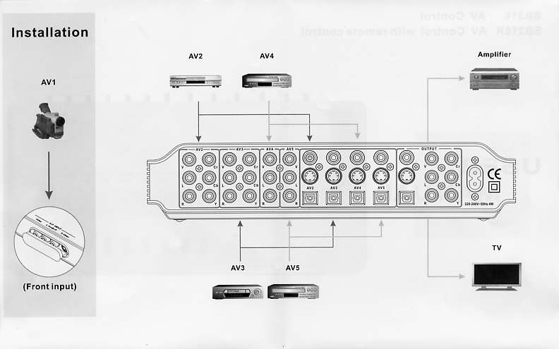

my choice is:
video : honeywexx component selector
audio : cheap cheap NEC decoder box with 2 optical in and one optical
out
it is enough in the bedroom la
作者:KGBII (218.xxx.xxx.35) 發表主題:11 回應文章:90 日期:2004-04-23 10:21
I bought this around 1 month ago, the component input support 480P
or above, now I connect Xbox & DVHS, no problem.
I like the auto select feature, no need to push the button every
time.
And if no signal input, will auto power off.
Its only cost $580.00, very good
The normal video ( RCA ) input does not support compmnent input.

I tried this it has problems with DVHS 1080i, the
frame will drift randomly but more so during explosions and fast
scenes... (confirmed with another DVHS friend also). Regular SD
sources maybe ok, but why use multiple component in ? Also the auto-
detect doesn't switch unless its a power on signal i.e. power up VCR
ok, but putting a DVD in and hit play doesn't trigger the auto-
detect.
Should have gotten two of Professor So's recommended units (one for
component, the other for sound, one remote control all)

外國牌子影子,方便之選,tonetron HK$650,旺角地牢最多女人個間買。初睇
冇乜特別,望真有埋光纖同軸select輸出,可光纖出同軸,反之亦可,最利害有
成四組咁多,在同區買一隻只可光纖出同軸單頭都要成四舊水。冇遙控可手動或
auto detect,要插電。效果唔識分,至緊要唔好衰過以前就得喇。
